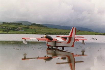

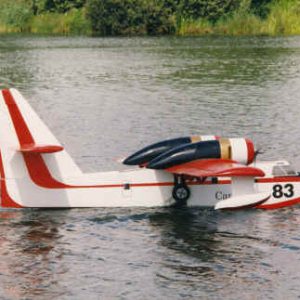

Jeremy produced his own drawings from three view drawings supplied by Canadair. They also gave him some other excellent drawings and construction details.
Work on the model started in 1989 and took one year to complete. A lot of the construction was done by John Newberry. The construction was of a traditional nature using ply and balsa wood. Flying surfaces were made from foam and glass covered. The complicated scale folding undercarriage was built by Ray Slack. The model was covered in large sheets of thin card of about postcard thickness.
The model was originally flown on Zenoah 62cc engines fitted with reduction gears. This was underpowered so alternative engines were sought. The replacement engines were 124cc 5-cylinder ‘Saturn’ radial glow engines based on the cylinder, piston and crankshafts of Laser engines. The building of the engines was done by Ray Slack who modified the crankshafts and built the cases. Neil Tidy of Laser engines also gave a lot of help during this project. The end result was adequate power and a very realistic sound.
As you can see, the model was fully amphibious and enjoyed many flights from water. The model flew well over three years and had approximately 50 flights before it spun-in after an engine cut and an attempted landing circuit.
