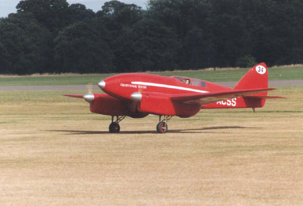

The model took over three years to build. Balsa wood was used whenever possible together with plywood and hardwood spars. The tail, fin, elevator and rudder are all balsa wood. This meant that only 7lb of lead was needed in the nose.
There is two degrees of washout on each wing starting at the nacelle and tapering to the wingtip.
The model is coated in a nylon/dope finish. Seven coats of non-shrinking dope were used on the front and two at the rear.
Spinners were 8″ alloy and supplied by Richard Rawle. Silencers were non standard stainless steel ones from Zenoah. The pilot was from AH designs. The wheels are caravan jockey wheels and the oleo legs were supplied by Alan Drew.
comet_cockpit
comet_fly2
Electrical System
There are separate RX, 3302 servos and 4.8 V battery for each aileron. These produce 9Kg. The other surfaces use a standard large model approach of two of everything. One receiver controls the left elevator, right throttle and flaps. The other controls right elevator, left throttle, rudder and retracts. The servos are 3303’s on 6V giving 14Kg pull.
The model has had over 100 flights.
