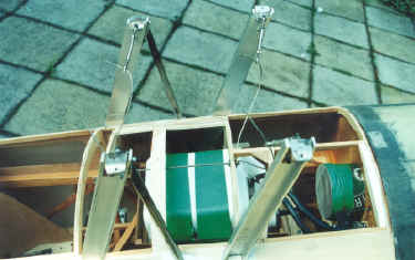

Underside of the fuselage showing the tubes bolted between the struts, lower wing dowels and the rigging straps.

The dural channel struts. The cowl was made using a blue foam former and split glass mould. It is 20″ diameter and 10″ deep. The laminated propeller made is 41 1/4″ x 11 1/4″.

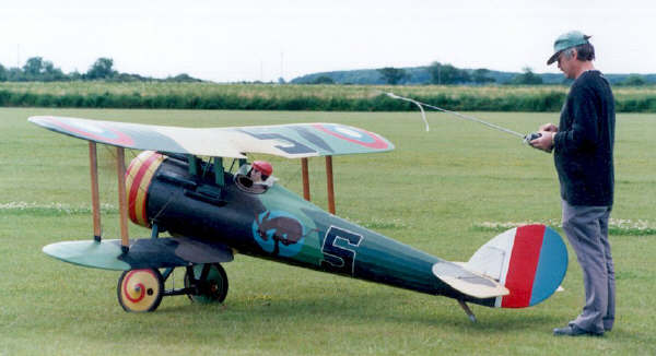

The model is covered in Polytex and painted by hand using Humbrol matte enamel. The kicking army mule is the insignia of the 95th Aero Squadron.
nieuportfly
(Longhorsley 2004) The aeroplane is not particularly easy to fly. The lateral stability is quite poor and turns need to be started with rudder and then reduced to prevent the nose from dropping. After the turn the ailerons are used to achieve level flight. It has considerable torque effect and hence turns more easily at low throttle than full throttle. Also, the plane turns easier to the left than the right.
The aircraft will easily ground loop when flown from a hard surface.
nieu28_4
Ian with his 50% scale Nieuport 28.
