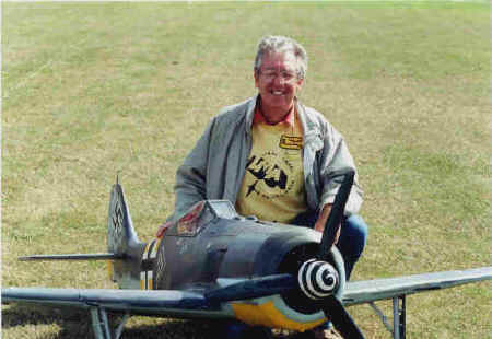

Rick’s Model
Rick’s aircraft is modelled on that of Walter Nowotny who operated on the Eastern front in 1943. He is reputed to have scored 258 “kills”. The model is a Fw 190 version A6 built to quarter scale.
Specification
Scale: 25%
Wingspan: 103″
Overall length: 88″
Height: 39″
Weight: 40 lbs.
Wing area: 1957 sq ins.
Engine: 215cc, 5 cylinder MacKay radial turning a 30″x14″ three blade Menz propeller.
The construction is built up of balsa and ply then skinned with epoxy and glass cloth.
The spar is a ply and carbon fibre composite structure since the undercarriage is mounted directly on it.
The spinner was moulded in carbon fibre.
The undercarriage is electric using the motor from a cordless Bosh screwdriver with 3.6v batteries. This drives a 25:1 worm and wheel through an irreversible gearbox. This is connected to the undercarriage legs by carbon fibre push rods and bell cranks. Retraction takes 5 seconds. Micro switches are used to indicate the extremes of the travel.
The radio system is based on twin Futaba PCM receivers with the channels split between the receivers. Four battery packs are used.
The paintwork is matt cellulose with a satin lacquer finish. Colours were supplied by John Greenfield.
Rick with his model.
