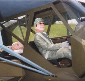

With so much Perspex the interior had to be detailed, in fact it probably took as much time as the airframe to build. Roy Vallancourt had sent me a copy of the operational manual of the full size and inside were pictures of the dash panel. This was enlarged and glued onto a 1/4inch light-ply back then covered with a very thin sheet of clear plastic. This was then covered with a sheet of 1/64 mirror ply with holes carefully cut out so as to reveal the clocks. The throttle quadrants and levers were made from small alloy tube. The internal tube work was replicated with doweling and the seat belt anchorage’s of steel wire.

The pilot and the wounded soldier where supplied by Pete Richards of Pete’s pilots and were moulded specially.
